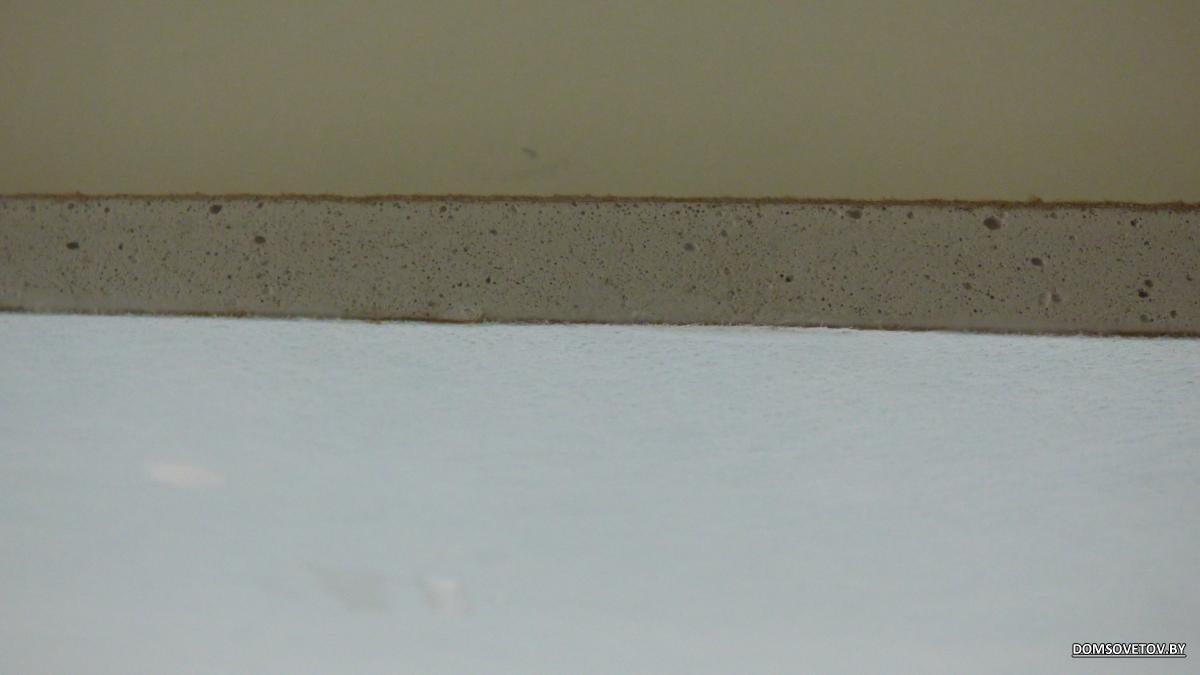

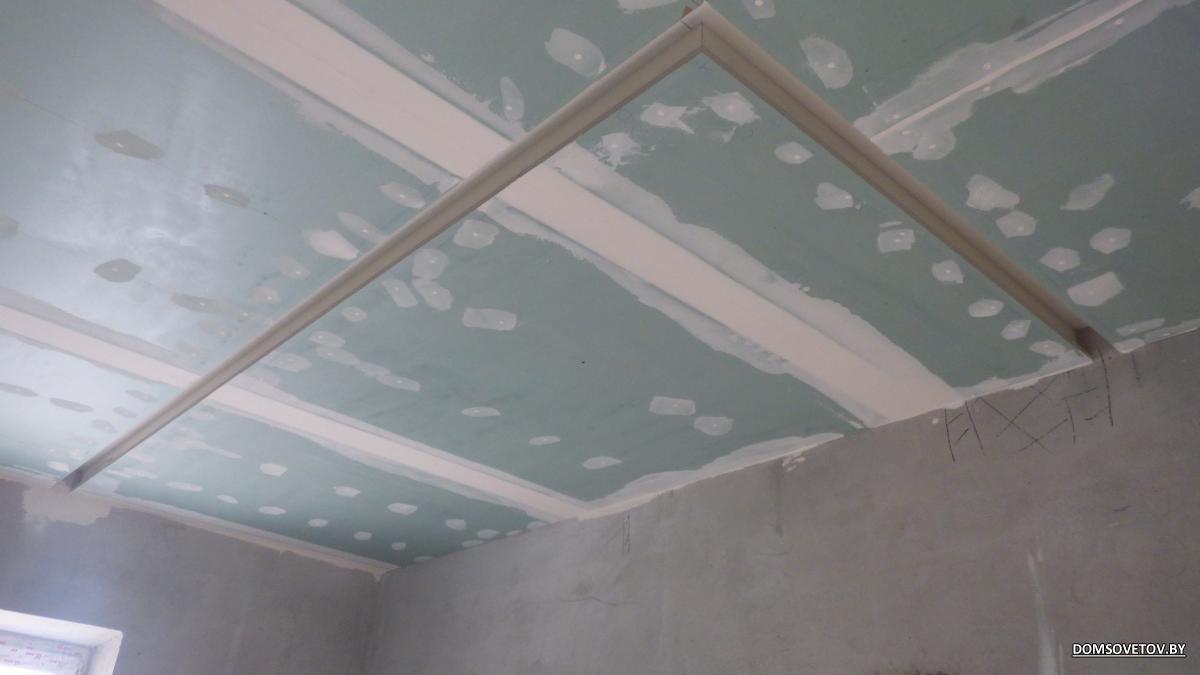

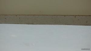

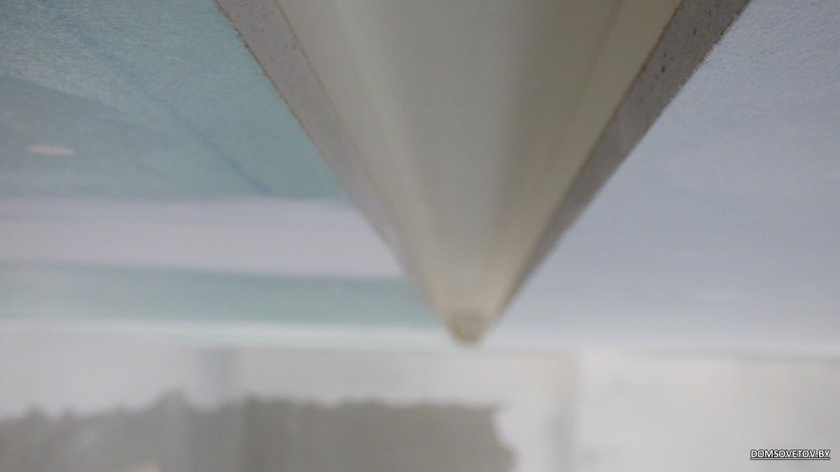

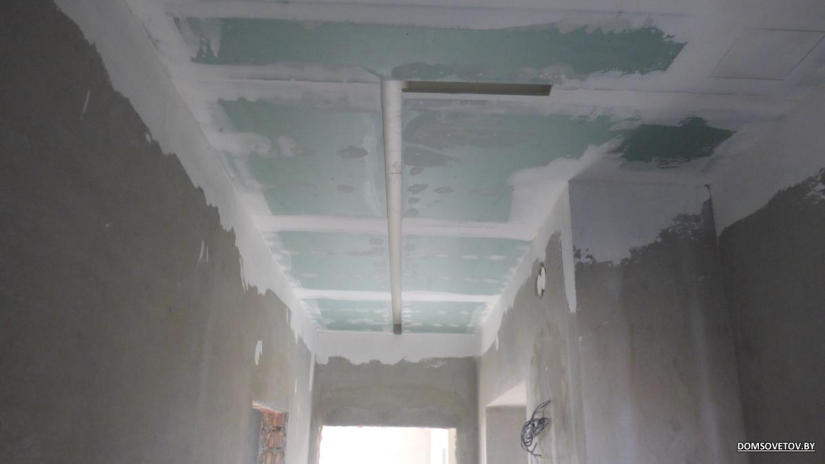

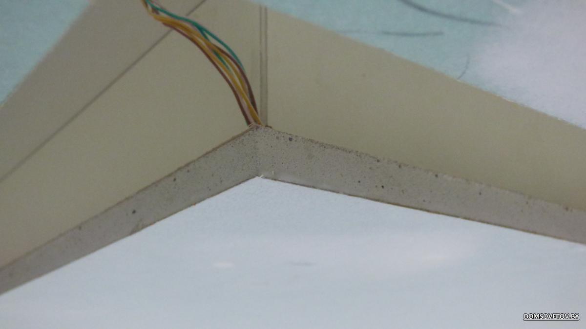

to TERRY83 http://www.domsovetov.by/imagehostin...6af81dddb2.jpghttp://www.domsovetov.by/imagehostin...6b26418ffc.jpghttp://www.domsovetov.by/imagehostin...6b5659f6bc.jpghttp://www.domsovetov.by/imagehostin...6b87441138.jpghttp://www.domsovetov.by/imagehostin...6bbb949775.jpg
